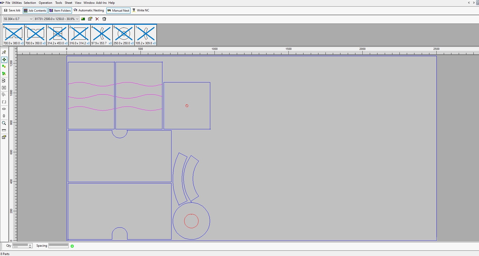

Hi All,
Hoping someone can help. We have nested a pattern in camduct & want to export it in .dxf however when export it is all in the same layer & we need it to be in 2 different layers (as shown on pic blue & magenta) as the magenta lines are effectively single line cuts which we need to be able to distinguish for our laser machine software (jetcam).
Many thanks for the help.
416 Views
1 Reply
Reply (1)
PatrickDavis20
In order to get the export to work the way you want, you will need to set up the DXF Output Layer Mapping to map CAMducts layers into the DXF file layers.
You can do this in CAMduct via "Database - Manufacturing - Tool Defaults - Layer Mapping - Export"
