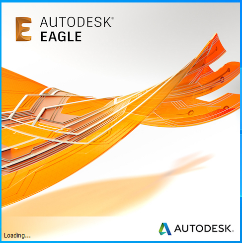

Unable to launch Eagle 9.6.2
I have installed Eagle 9.6.2. I verified that I am a student and have an account. When I click on the icon, or try to open it as an administrator, it comes up and says loading and then it just disappears. It won't go any farther than that. I don't know how to fix this. I have uninstalled and reinstalled, restarted my computer (windows 10 on surface pro 7) and tried opening by clicking on the OpenGL in the program folder.

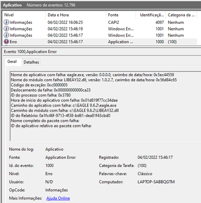

Eagle 9.6.2 doesnt work on Windows 11.
Open Event Viewer.. select Windows logs, Applications Sort be Level.
App ErrorApp Error
Message 18 of 26

Got it to work by removing the following dlls from the C:\EAGLE 9.6.2 directory:
1)  libeay32.dll:   OpenSSL Shared Library part of The OpenSSL Toolkit.
2)  libEGL.dll: ANGLE libEGL Dynamic Link Library file, was created by Autodesk, Inc.
3) libGLESV2.dllANGLE libGLESv2 Dynamic Link Library. LibGLESv2.dll is developed by Mozilla Foundation.
4) openGL32sw.dll: Software implementation of OpenGL bundled with Qt.
5) ssleay32.dll: OpenSSL Shared Library part of The OpenSSL Project,
I can do this because:
a) I have GitBash for windows installed which comes with OpenSSL
b) I have a hardware GPU which comes with its own Graphics Library (not using OpenGL)
c) I have PyQt5 installed which comes with all its requisite dlls.
Message 19 of 26
