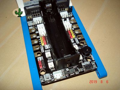

Hello, to the community. (and staff)
Recently a beautiful specimen of electronics has fallen into my hands.
When I saw the labels, I fell in love. 🤣
Pay attention to how the labels were made.
The text is cut from the background. This looks great and is much more readable than a simple text.
I'd like to be able to make these inscriptions on my PCB.
I tried to find some post on the forum about this topic. However, it was not successful. 🙄
I doubt I'd be the first to make this up.
However, I have to ask if anyone knows how to make such labels

<если Вы хотите вырезать ТЕКСТ в области полигона - поместите ТЕКСТ на слой Restrict>
if you want to cut out the TEXT in the field of the ground - place the TEXT on layer Restrict

<если Вы хотите чёрный ТЕКСТ на белом фоне - нарисуйте прямоугольник на слое Place (будет белый, если шелкографию заказываете белой) поместите ТЕКСТ на пользовательский слой (>100), не забудьте сделать САМjob, укажите производителю печатных плат, что этот слой шелкографии нужно сделать черной краской>
if you want the black TEXT on a white background - draw a rectangle on Place layer (will be white if you order silk-screen printing white) place the TEXT on the user layer (> 100), do not forget to make CAMjob, specify to the producer of printed circuit boards that this layer of silk-screen printing needs to be made black paint

When I forced myself to make an intellectual effort, I remembered that I had already made such an inscription in the form of holes in the layer of copper (1 or 16). 😂
But I still don't know how to do it in layer 25 or 26 (tNames bNames). I think we would have to define a Restrict layer for them.
Do you have any idea

<Нет. Представьте процесс изготовления PBC.
Нанесение надписей (шелкография) производится краской с ограничением минимального штриха (толщина (задаем в % (RATIO))) и высоты знаков (SIZE).
Не знаю как можно сделать вырезы, но думаю будет выглядеть плохо (наплывы) и плохо читаться.
Пером пишем знаки, но обвести знак заливкой пера трудно.
Проще заказать светлую маску платы и темную шелкографию.>
No. Present PBC production process.
Drawing inscriptions (silk-screen printing) is made by paint with restriction of the minimum stroke (thickness (we set in % (RATIO))) and heights of signs (SIZE).
I do not know as it is possible to make cuts, but I think will look bad (flows) and it is bad to be read.
We write with a feather signs, but it is difficult to lead round the sign filling of a feather.
It is simpler to order a light mask of a payment and dark silk-screen printing.
