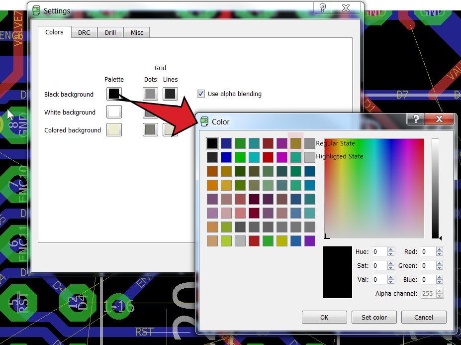

Do you have any plans to make the "show" command to show colours in more obvious/clear ways, as an example as Mentor Graphics PADS which lights up nets in WHITE (picture example) instead of as in Eagle (att least earlier versions) which highlights the nets very dull, almost not at all both in the schematics (which is almost impossible to even notice!) but also in the PCB, which though is a little bit better but far from optimized. I contacted Cadsoft a few times about this a few years ago but they preferred to never even reply. Or have I missed something in the Eagle setup?

Greatly appreciate your participation on the forum, I apologized if we didn't address this earlier with you. This hasn't change much in EAGLE, but there are a few things you can do to improve the highlighted show notification.  As you may already know EAGLE has the option for Alpha Blending selected by default.
If you click on Options/Set, click on the Palette corresponding to your background color.  The fist row will be display the colors used in EAGLE at their regular state, while the second row show the highlighted version. For this example location (1,7) is the regular state color used for airwires and location (2,7) is the highlighted state.  Consider changing the color for the highlighted state the best suits your preference.
Consider deselecting the Alpha Blending result option in the Palette Dialog Box, you can test different color combinations.
I hope this helps.
Best Regards,
Ed

Thanks for your quick reply. Your suggestion works great (in PCB); I was choosing white color for both the bottom and the top layer in this case to try it out, just to se the complete net in the same color all over the PCB (see pcb picture)...  but I don't get it to work in the schematics, must be something I do wrong, when I do the same as you suggested for the PCB. I would like to have some kind of green color for the not highlighted "net" and something like screaming red or black or something for the highlighted net, in other word big contrasts between not highlighted and highlighted. It seems to work, though, if I choose black background for the schematics (OPTIONS/USER INTERFACE/SCHEMATIC/BLACK) but that way it's not good for the eyes working with the schematics (I'm not used of that). Any ideas?
Actually the colours/palettes are completely different here when comparing "SET/COLORS/PALETTE" with "VIEW/LAYER SETTINGS/NETS/COLOR" (see pictures).
 PCB (WORKS GREAT)
 SET/COLORS/PALETTE

Hi @Anonymous,
I hope you're having a good day. Remember that schematic uses the white Background so you would have to adjust the white palette to get the same effect.
Please let me know if there's anything else I can do for you.

Thanks again, yes, now a very good day thanks to your help! Of course I have to change the white background settings the same way, now I understand it better after you have explained why the "COLORS" settings are there and what they can do. It's still a bit confusing with the COLORS settings but I think it will be easier from now on. Great support from you guys.
