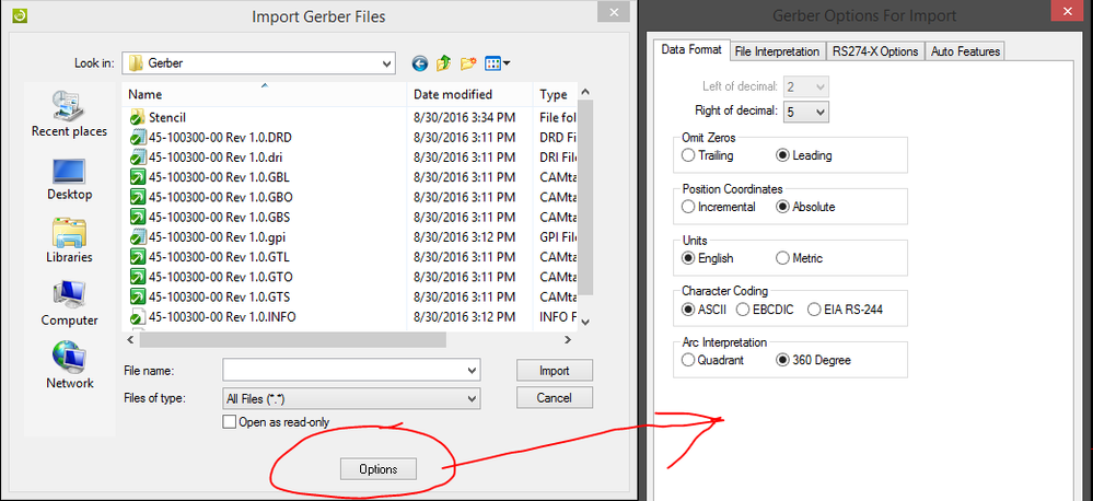

C.Nicks
I use viewmate almost exclusively to review gerbers and have had a few problems over the years. When you go to import a gerber (or folder), select options from the dialog. From there you can tell it what format and units to import. For some reason most of my old scaling issues came from it importing metric when the files where exported in inches (the file even had the gerber unit for inches, but it got ignored for some reason).
