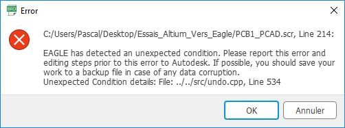

Hi everyone,
take a look at the joined archive, it contains a pcad ascii pcb, and resulting conversion in Eagle.
However, as I said above, there are non blocking errors like that:
By clicking OK until the end, it works.
Thanks a lot in advance for your help !
Pascal
Message 18 of 40
jorge_garcia
Hi @Anonymous,
I hope you're doing well. Thank you for the file. I was able to see the exact same assert, I've created a bug report for this.
