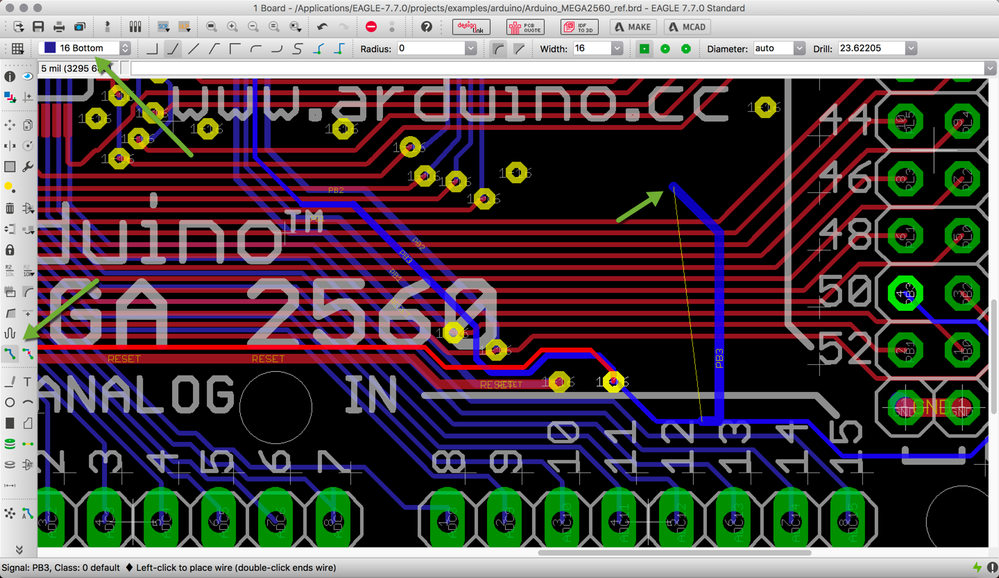

I thought I already posted this, but I can't find it anymore, so here it is again.
The behaviour of the board layers' visualisation is very confusing with 9.1.0. I opened an existing project from 9.0.1 and the pcb looked like mirrored, with the BOTTOM layer shown on top of all the others. Then I modified something on the TOP layer and suddenly this was on top of all the others. Every time a layer is modified it's moved on top, and this is really annoying. This happens with version 9.1.0 both under Win7 64 bits and Linux Mint 17.3 64bits.
8,053 Views

Are you by any chance in single layer mode which is now available across all the board tools and not just in route mode? It sounds to me the different layers are popping to the front because it's just highlighting the active layer and maybe greying everything else out?

Actually, scratch that, I've just seen what you are seeing. Yeah that seems odd....

The concept of an active layer has been implemented in EAGLE, I don't recall if it was available in the previous release or not(I think it was). Whatever the active layer is chosen to be, it is always drawn on top of everything else. I believe this is intentional and is supposed to help with selection. Even if single layer mode is not active this property is still in play.
Let me know what you guys think.

I understand someone can find this helpful, but at the moment I find it confusing. Is there a way to disable this function? Or at least to refresh the view and bring the layers in the right order to check if everything is where it's supposed to be.

I find this behavior to be disconcerting as well when routing multiple layers. In my minds' eye I have a concept of what layer things are supposed to be on, and to have the "currently active layer" jumping up and down on me breaks my concept of "above" and "below" for active layers.
If I've ever needed to route a single layer, I've always just turned off the view of the other layers', and done that layer alone, then turned them back on again. In this case, the automatic layer jump to top in visibility is more annoying than useful.
It seems to be another one of those features that someone did, but nobody asked for... I find a number of "improvements" to be annoying, including some of the automatic routing stuff: I mean, if I'm running a trace from A to B, I really don't want Eagle automatically suggesting I run the thing all the way around the perimeter of my board. There's probably a Very Good Reason that Trace needs to be in about the area I'm trying to put it in. This also makes it difficult to maintain uniform trace spacings without adjusting the DRC settings, and many of my designs routing multiple signals of wildly different widths and requirements (say, MosFET drive signals snaking around high-power traces), which makes the automatic width stuff a little irritating.

Also chiming in for a way to disable this. I can see how one may use this while routing but it is not something we always want on.
For example we will always do a visual inspection of what side our PTH parts are on before ordering any hardware. (which are marked in tplace/bplace) but now this order is not fixed and it is hard to perform this check in a way I trust.
A button to force the render order to the physical board stack would be extremely appreciated. (Ideally on the toolbar so one can go back and forth depending on what one is doing)  I have poked around some and not found any such option.
It is also someone confusing as to what order the non selected layers are rendered in. For example when I select bplace it always seems to render tplace above top as well. When doing visual inspections this makes it impossible to inspect bplace while being able to tell it apart from tplace where as this is really easy if the layer render order is based on reality.
We could reset the viewed layers 3-4 times every time we look at a board but that seems needlessly time consuming for something that should just work if the view matched the product we are designing.

Let me give you a point of view here and a little backstory to help you better understand what you're seeing and why / when this becomes important.  This means tipping our hand a bit so here goes:
We are working hard on refactoring selection in EAGLE to support direct-selection (i.e. non-modal move, group, etc).  So for example:

The point here is that in reworking the internal selection mechanism (as you can imagine, this touches just about every aspect of EAGLE) we needed to introduce the notion of selection priority.  Now since this hasnt been fully implemented yet, the ability to have a "Current Active Layer" probably feels a little odd, but here's the essence of why this is important and when this is implemented, the role this will play...
When you want to select objects with "Direct Selection" like you would in Powerpoint or a drawing app, we have to perform a hit test.  When the current layer is selected, we can prioritize that layer above all others and in the case of ambiguous selection, resolve that the current layer is most likely the layer you want (otherwise something like a bottom layer polygon might dominate top layer object selection).  Now this is hardly the extent of the nuance here and for the team, this is not our first rodeo building selection systems before.
In some cases ambiguity is resolved smallest to largest (object area versus object area) and in some cases it's current layer versus other layers...In eCAD, unfortunately, it's all of this and a LOT more (imagine if Frames were the only thing that kept getting selected or again, a polygon on a different layer...each has both a selection "area" but also a selection "layer" and even an implied selection "priority" whenever ambiguity is detected).
To make much of this work, layer-based tools (Photoshop, Illustrator, etc) have the concept of a "Current Active Layer" and this is by design, for very good reason.  Otherwise, it's likely that a paste may not be pasted on the right layer (ever wish EAGLE just pasted on the current layer?) or a selection might not be selected on the right layer, etc.  All of this is harder than it needs to be in EAGLE because solving the harder problem of implementing Direct Selection has been something which has been punted on, time and time again, simply because of the scale of the change involved.  When we took over, this was one of the first things we knew we needed to get started on and we began this process with a massive refactor over the last 18 months.  Some of what you've seen in terms of bugs or changes in behavior are the result of these things getting slow-rolled into the tool.
Since we've begun this effort (and it has taken a loooooong time to even get to this point), the Current Active Layer was introduced to roll out some of what's necessary to support the bigger changes on the horizion.  As such, it probably feels a little weird since it's only a slice of a much bigger initiative.
That said, the concept is something that will stick around out of necessity, but I agree, in general, that having the ability to view the board "as-built" would prove useful.  But consider this...Even *that* is misleading until you get to CAM and send boards to your fabricator!

Now I want to start by sharing an image and I'll come back to this later.  Just have a look and I'll revisit this in a second...
Much of what you indicate in your post seems related to the ordering of signal layers and I agree with you 100% about the specific ordering of these.  You chose these layers for a reason, the layer stackup definition in the DRC dialog defines this sequence, and how we represent these in the layer stackup is critical.  I have done countless wireless boards and high power, HDI, etc and know the issues here intimately.
My comment about layers not making sense is that there is NEVER a scenario where top soldermask and bottom soldermask are adjacent to one another, however in EAGLE they are, in terms of the enumeration of layers.  This is in fact NOT a reflection of your board or your stackup at all, but instead something EAGLE has accepted as fact because it made layer "pairs" easier to manage internally (flipping from A to B is easier if A is adjacent to B in the enumeration of the layers).  The comment about this all getting sorted in CAM is largely true because people tend towards README files and a layer stackup in Gerber or worse still, in file extensions to define the layer ordering.  In PCB, it's only valid because of the drawing order and not the data model.
So you're correct that layer ordering for signal layers in not ambiguous, however it is also not consistent with the ordering of non-signal layers and worse still, the lack of discipline in non-signal layers has created a long history of confusion and lack of consistency that at some stage, would be nice to resolve.

So Matt, you are right the current layer does pop to the top in v7 while routing, I like this as it means I can see my layer clearly while I am routing. But it only needs to come to the top when there is an active tool like it does for route in v7 (and probably earlier) through to v9.0. It could probably be extended to also happen when other tools which change copper are active too and not just route. But having it put a layer to the top of the visual just because it is selected in a layer selection box and doing this all the time is unnecessary and distracting. This could still be used as part of a new selection mechanism without making it always draw it on the top even when doing nothing.

OK, after working a bit with version 9.1.0 and 9.1.1 I found a little workaround that allows me to go back to a proper stack view. I choose MOVE or SELECT and select layer 20 (or higher) from the drop-down menu. This usually resets the view.
It would be VERY nice to have a button that does just this...
