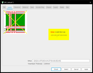

Moving on to my next question, I have a complex layer definition in Fusion that Eagle cannot follow (I encountered numerous issues trying to defining it in the layer setup bar).
If I save a .brd file in Fusion and then open it with Eagle, will that definition be read and understood?
In addition to the above. For this project, I have found it very comfortable to work with design blocks but so far if I have to apply corrections, which would mean modifying the block, there is no way to update the whole design. I found THIS thread from 2017 where they address this issue. Is there any update?

So if you export it to EAGLE the definition should be understood. With that said, I would like to inquire what you have such a complex via stackup. Making a board like this would be EXTREMELY expensive. If you need it, you need it, but I want to make sure you are not under the misconception that you need to have a via config between every possible combination of layers. For example a via that goes from 1-16 can connect all layers, it will isolate from any layers it's not supposed to connect to. Generally, you only really need blind and buried vias for tiny dense layouts. I recognize you have a dense layout but you may be able to do it with fewer via configurations.
