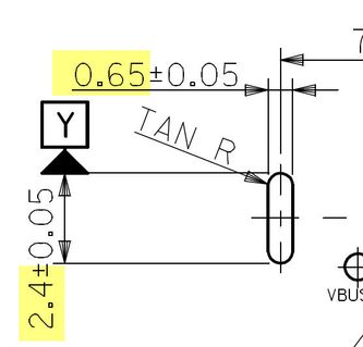

Need to make two slots for the side tabs on a USB Connector.  I have read posts and think I know what to do but want to make sure.   I have pads for the shape of the slots and then on layer 46 Milling, I drew a Wire the width of the slot needed.
Wires drawn on layer 46Wires drawn on layer 46s
1.  Is this the correct procedure?
2.  Do I need to tell the board house anything specific, or is the Mill Layer info enough?

Yes, that is about the best way to create slots currently in EAGLE.  However, you should have a PCB drawing or other document that clearly points out the slots, lists the details (like the intended slot width) and that you want them plated.  And you'll need to include a gerber file for the milling layer as well.
If you are using a prototype service that can't do slots, then the best you can do is to use a drill of the diameter of the length of the slot.  That takes a lot of solder.  When I need to do this and it's a hand build then I'll make the hole diameter just slightly smaller than the width of the pin so that it's a bit of an interference when inserted -- that keeps the solder you'll need to a minimum.  The bigger the hole, the more solder you'll need and the more likely you'll get a blob getting shorting out to the real pins.  However, these holes are big and if they interference with the signal pin drills then this won't work at all.

I hope you're doing well. The slot should be made up of a contour of 0 width wires on the milling layer. Don't just use one wire with the thickness of the slot. The way you did it could work in older versions but the procedure now is to draw the slot contour.
Outside of that everything else James said is spot on.

Thanks Jorge.  Like this?
Message 6 of 11
jm2morri
That looks good.  The zero width just removes the confusion about whether you want the tool to follow the center of the outline or the outer dimension (or inner dimension for that matter).  So that is why zero width is good.
As for your drawing, it looks OK.  You likely to make the pad a bit bigger to have a bit more copper left over, but it's not awful.  You should also confirm that your PCB fabricator can route a slot that narrow.   0.65mm is 0.026" and I know that ~0.032 is the smallest some places can route.  Confirm with your PCB fab what their minimum is and make sure the width is at least that.
