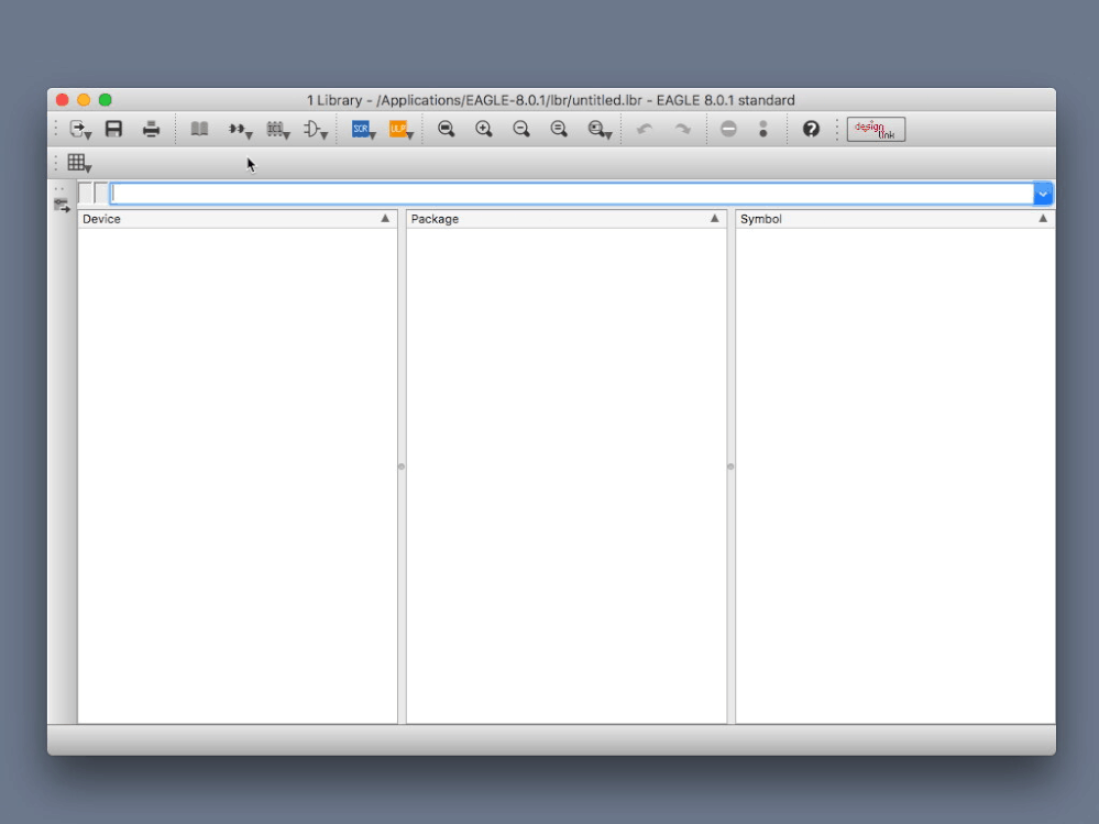

I have a very annoying problem in Eagle 8.0. If I edit a custom library, Eagle suddenly hangs. There is no way out, and if I try to close the library or even the application, I get only a message "Can't close window while command is running!". The only way out is to kill the application - so I lose all unsaved changes to this point.
It seems this happens if I rename symbols or packages, or cloning them in the library. After I switch to another package or symbol, Eagle hangs.
Is this a known problem? Is there any solution?

Amyoqzy
The problem still exists in 8.0.1. It seems some fundamental problem of the user interface. It only happens often in the library because there is some strange delay after each action. It can best be seen after switching to another mode. The status bar needs sometimes longer than a second to finally show up.
Here a demonstration of the problem. A video with a higher frame rate is attached.
macOS 10.12.3
Mac Pro, 32 GB RAM, 3.5 GHz 6-Core Intel Xeon E5
