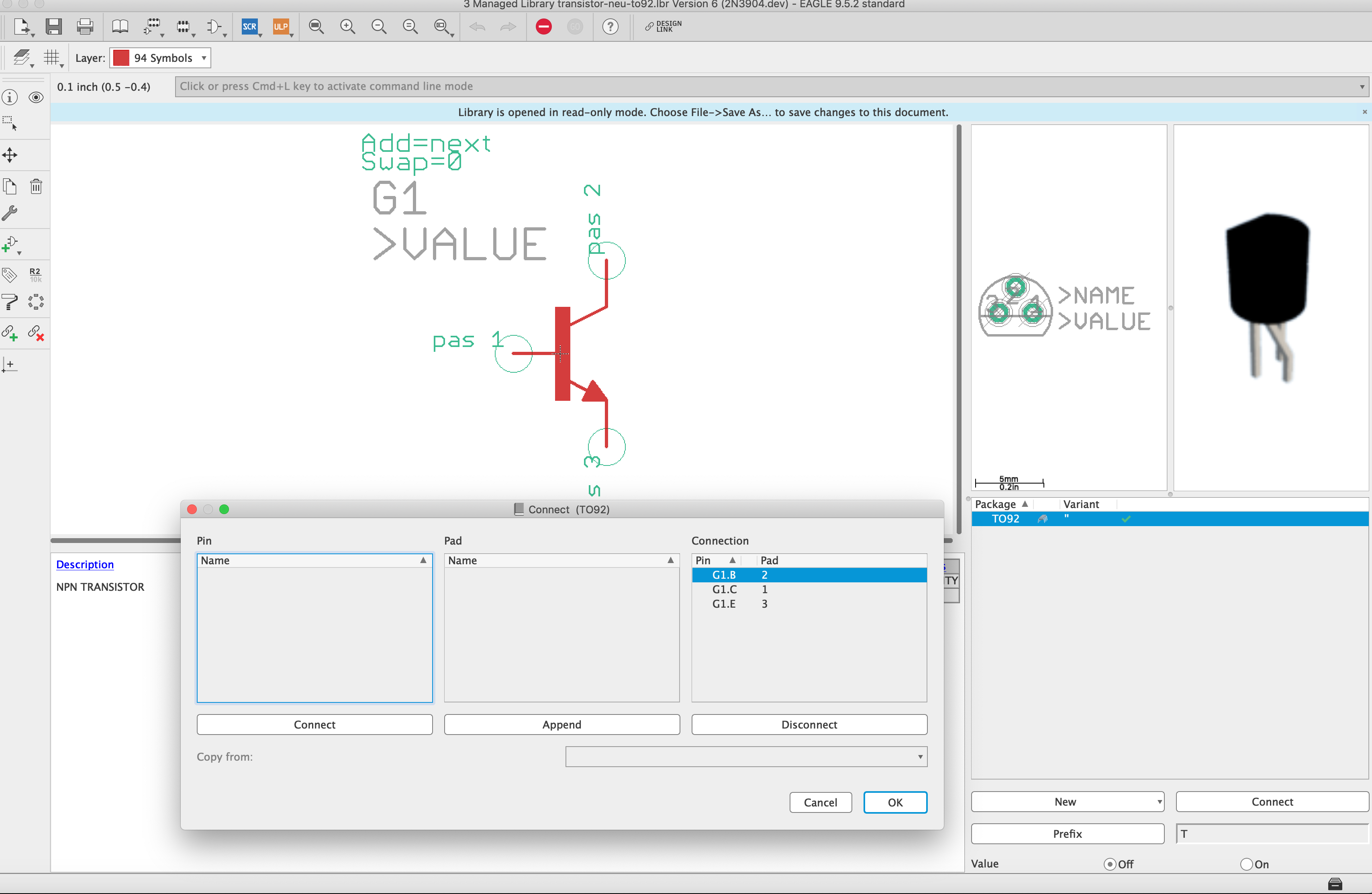

Also, the same 2N3904 in "transistor-neu-to92.lbr" has totally different pinout - I don't understand... Why the Collector is in the middle?

Please note that different transistors the pin arrangements may change - however seems like you want to keep the consistency of your symbol names to that of the footprint -  this is not the case you arrange your footprint pins as per the datasheet.
For instance, you may have name 1 for Collector on the symbol, 2 for Gate and 3 for Emitter - Now when doing the footprint be keen on the arrangement how the pin numbers follow each other is not of concern, that's why I mentioned you could name them as C, G, and E then also name C, G, and E for the footprint - you will then place you pads as per the datasheet, this is also a 3pin THT component so as long as you have the middle one done well you have least to worry about.
Supreme rule follow the datasheet

Thanks for this.I thought so because it seemed logical to me. However, the example below (see attachment) is misleading for me. On one side, the pins of the symbol are numbered so that they do not correspond to the numbering of the pads. Is there a reason for this? This is the original Eagle library.
Message 14 of 14
one-of-the-robs
That does look as if the pads are numbered backwards compared to the datasheet, but the pin mapping adjusts for that. It may be the particular variant of TO92 was drawn for a datasheet that numbered the other way, then re-used for the 2N3904.
