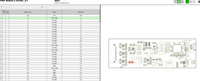

I want to use these model numbers, which is from a library.
