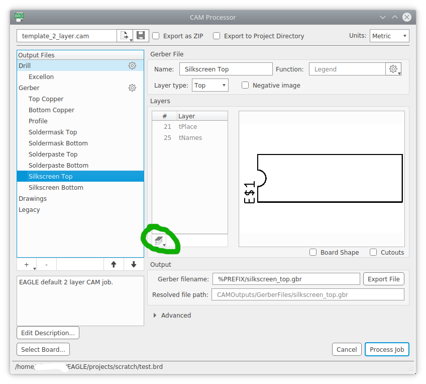

Eagle has essentially two different types of CAM processing, a new style introduced after Autodesk took over Eagle, and a legacy style from old versions of Eagle.
Assuming you are using the default template, you will be using the new style. In this case, navigate to the silkscreen top and bottom section in the left side of the screen and click the button in the lower left corner of the layer list. This will let you edit the list and add or remove layers from the job.
If you are instead using the legacy style of CAM processing, for example because you are following a guide you to open the gerb274x.cam job file, you need to double click both of the silk screen sections under legacy in the file list. This will convert them to the new style of CAM job and you can then edit them and follow the same step as above.

Well, I found how to adjust what layers are going to be shown at silkscreen. This is done from CAM processor
