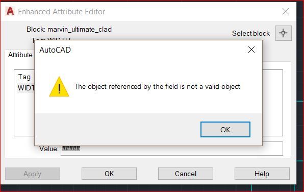

I created a dynamic block for a standard clad window, and I have a width attribute that is supposed to state the width of the window based on a line that stretches. However, all I can get it do is read '####'. Everything within the block looks okay, and I've tried UPDATEFIELD and ATTSYNC, but to no avail.
Any help is much appreciated.

Hi @johnrmcwatersiii,
Thank you for the file. It looks like the Field object shows as not valid when I double click the field value, and Unknown in the Field dialog.  Try reselecting the Field object.

Message 5 of 11
johnrmcwatersiii
@cheryl.buck
The definition is referenced to a line within the block. Could that be the reason it's unable to find anything when you double click it?
Message 6 of 11
Libbya
Object fields are less reliable than BlockPlaceholder fields.  Considering you already have the Window Width parameter which appears to be the value you are trying to display, I would recommend eliminating the object field (and the line it references) and using an BlockPlaceholder field referencing Window Width instead.

johnrmcwatersiii
@Libbya
Thank you for the input. I may try that, but for some of these blocks, the width read out will actually be different from the total width of the block. For instance, if the window as brick moulds on either side.
edit: I see what you're doing now...you can reference the window width as a parameter.
In that case, the concept is the same.  I think you will find that you get more reliable field results if you add an appropriate parameter instead of a line and use that parameter value as a BlockPlaceholder field rather than an object field referencing a line.  Have0 grips for the referenced parameter if you want it invisible.
