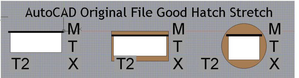

I have created a library of dynamic blocks to distribute.  But my testing finds too many errors when blocks are stretched. For instance in the following block (274100-004-ID MASKING SCRN.dwg), I completed the editing and tested the block in the BE command. Here is the picture of the stretched blocks (note, the origininal stretch point aligns with the T2 on Std view):
I inserted this block in my test drawing, stretching both the Std view and the Boxed view (with the brown background).  But the results were dramatically wrong in both views:

I am getting VERY frustrated with AutoCAD Dynamic Stretch on Hatch patterns.  I went thru every block I have that uses stretch and redid the hatch patterns, tested them and placed them in a library drawing.  Each stretch block works find on the library drawing and in Test within BE.
Now I am testing my CUIX and most of them (but not all) blew up.  Here is an example using the attached 274100-005-OB PROJ SCRN.dwg
1. Test of original discreet block
There were no stretch errors
2. Tried same thing on the Library file with good results:
3. Using my CUIX, I placed this block in a new test dwg and most of my 20 items with stretch do not work correctly.
