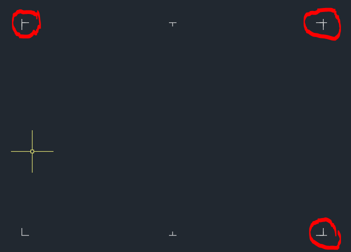

This is a very simple block with an A4 cut and folding lines.
There is no problem moving the cut lines in increments of 210 mm one way and 297 mm the other way.
My problem is the folding lines between. They are set as an array with increments at 210 / 297 mm.
They should only be visible between the cut lines, but they are also visible at the last cut lines.
I can solve this by simply drawing cutting lines at all the corners, but is there possibly a more elegant solution.
The file is attached.
I am no expert at dynamic blocks so I'll need answers at beginner level 😉 or a link to a tutorial.

The problem was your linear parameters were too long. eg for the cuts to happen every 210 your first linear parameter needed to be 210 long.
See the attached drawing. My block is in green and below yours.

That dos solve my problem with the visibility 🙂
It just leaves me with the problem that I can't go down to the smallest papersizes A4 or A3.
Would that be possible in any way?

try attached file
Thank you ojuris!
So the solution was to have to different parameters chained together.
And a visibility setting for the smallest version.
A very convoluted way for a simple block, but very elegant results.
