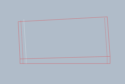

I'm trying to develop a dynamic block that will represent a 45 degree fitting for some pipes.  When I try constrain the vertical line, I just get a message telling me that the vertical constraint can't be added.
I figured I'd come back to that and moved on to try and deal with making the angle constrained to be the same at all times.  It's telling me the two lines are parallel!  The two black lines are the ones I'm trying to assign angle constraints to.  What I'm shooting for is the ability to choose a pipe size from a list and have that pick from the block table the od, fc, a & b dimensions and to have all the lines below the diagonal mirror the diagonal.  Any ideas why it's fighting me?  I'm going to post the dwg in case someone wants to see it.
Never Mind.  After continued troubleshooting, I found that they were not all on the same Z elevation.  I moved everything to zero and it's working as expected.

From what I see, I wouldn't use any constraints at all.  I'd just use dynamic parameters/actions and either a lookup or block properties table.
Some of your issues adding constraints may be because your linework is not all on the Z=0 plane.

Thanks for the assistance!  That did what I needed....for the most part.  Your version removed the inside pipe walls (the hidden lines).  I added them back in and successfully modified the actions that you had created so that they get moved as appropriate as well.  Thinking that I understood what you were doing, I attempted to the same thing for the 22.5 degree elbow.  OMG!  EVERYTHING moves at weird angles.
Just like with the last version, the angle should stay the same and just change the dimensions.
To be clear:  I'm not asking for anyone to do it for me -- this is something I really want to learn.  But none of the DBlocks I've created in the past used lookups.  They all used visibility to turn things on or off and/or used linear dimensions IN ONE DIRECTION to stretch something out.
Here's what it looks like within the block editor:
Now outside the block editor, I've set it to use "2" from the lookup list:
And this is what it looks like when I use "63" from the lookup list:
I'm' attaching the final working version of the 45 elbow (with my inside wall lines shown) as well as the 22.5 elbow that's currently giving me grief.

The angle of the fitting is currently set to 23.401839°.  Is that correct or should it be a true 22.5°?  The miter angle is at 11.7009195°.  Should it be 11.25°?
You placed the fc parameter backwards of how I placed it in my example.  If you have the grip turned off then it doesn't actually matter which direction you place it as it will never show.  However, you must remember that the startpoint (bigger X) will never be moved by the changing of the lookup value.  Only the endpoint will move.  Because of that, all actions that you would like to act via the lookup need to be associated with the endpoint, not the startpoint.  The direction the action needs to act can be adjusted in properties after selecting the action and modifying the angle offset property.  The angle offset is relative to the direction of the parameter movement.
The following assumes that you keep the fc parameter oriented the way it currently is.
You associated the Stretch1 action with the correct endpoint of the fc parameter.  However, you need to select the Stretch1 action, go to properties and change the angle offset to 22.5 in order for it to stretch in the correct direction.
You associated the Stretch action with the startpoint of the fc parameter.  As mentioned previously, the startpoint is never moved by the lookup, so it will not do anything as is.  Delete it and remake it.  This time associate it with the endpoint of the fc parameter.  Then select it, go to properties and change its angle offset to 180 (it needs to act in the opposite direction of the endpoint movement.
Stretch10 and Stretch11 are set up correctly.
Stretch14, and Stretch15 need their angle offsets adjusted appropriately.
Stretch12 and Stretch13 need both their angle offsets adjusted appropriately AND their distance multipliers adjusted appropriately.  The distance multiplier changes the distance the action acts over per each unit of movement of the parameter grip point.  The easy way I have found to accurately find the necessary distance multiplier value is to draw a right triangle with one line of 1 unit length in the direction that the parameter grip is moved and then finish the triangle in the direction you need the action to act:
Bear in mind that the value will not be correct if the miter angle should actually be 11.25.

I forgot to mention that the od parameter needs to have its Base location changed to midpoint.
I attached an updated version of your block.  I did not adjust the angle to 22.5.
If you make a single block with visibility states for the different angles, you can use the od and fc parameters along with the some of the stretch actions in ALL of the visibility states and then just add the necessary stretch actions for the modified angles.  You could also use a block properties table for a single pulldown grip that would access all of the angles/sizes.
