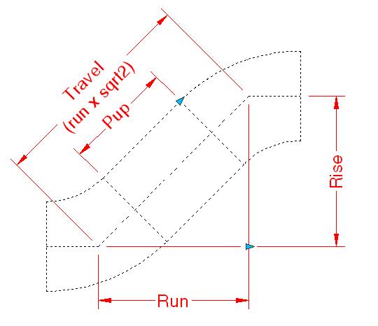

I'd like to make a pipe offset block that can be sized either by the offset distance or by the length of the "pup", and I'd like to do it without using any of the parametric constraints.   In the attached example, the sizing the offset with the "Run" grip also moves the "Pup" grip as expected, but I can't seem to get the "Run" grip to stay in the proper position when sizing the block by the "pup" length.  Any suggestions?

Thanks ojuris, that's what I was missing. I did need to change the multiplier for the new stretch action from 1.414 to 0.707 in order to keep the grip properly aligned and have Properties report the correct "Run".  My first attempt adding "Flip" seems to have broken it, so I may need some addtional help if I can't figure it out.

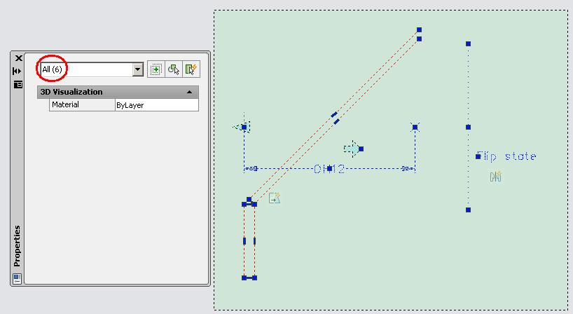

Well, there's the problem.  One of the 14 entities in my block is being ignored in the selection set, and it appears to be the stretch action.  It's not specific to that block either,  I stripped down your roof block to just 2 objects, 2 parameters, and 2 actions and it flips/streches fine.  I can change and/or modify the number of items in the original Flip selection set, and it continues to works as expected, however if I delete your original Flip action (which has all 6 objects in the selection set), and try to create a new Flip action that includes all 6 items, I cannot do it.  The selection set only "takes" 5 of them even though 6 were found.
998i9498D72BEBBBDCCF1000i052D553C575210291002i5E679EF078B4C995
As you can see in the last image, All 6 items "highlight" when I click on the flip actions icon, but only 5 show in the selection set for some reason?  I'm currently searching for a system variable that might prevent certain types of parameters from being flipped.

Number 6 is most likely the Flip State itself and therefore will not be include in the Flip Action therefore 5 will be the counting(?). And I think you will find that including Actions in Actions tends to lead to undesirable results in most cases. Therefore adding Actions to Actions willy-nilly should be avoided. (Unlike ehat I have done here.)  I've not read anywhere of a limitation of an Action not being able to be added to an Action just that a Polar Parameter can not be used with a Linear Action. I have had on occasion a warning of a 'circular' (I don't think that is the right term) reference being detected and therefore an Action could not be added.

The 2nd block I posted has 13 entities in it (not counting the basepoint) but the most I can get in the Flip Selection Set is 12. May I ask how many were in your flip selection set (I'm assuming all of them since it works for you)

I can Qselect the entities and come up with 18 total and figure the Basepoint and the Flip Action itself are the two missing.

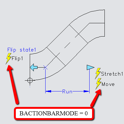

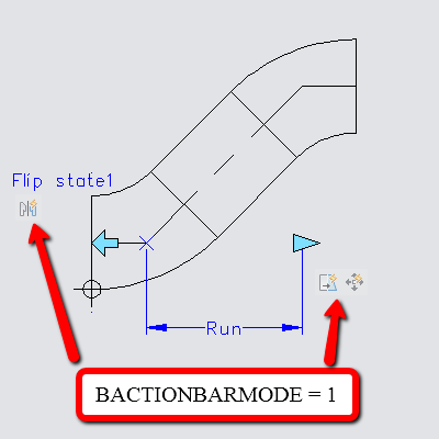

The reason the number of objects selected are different in this particular block when editing in the AutoCAD 2010 and later Block Editor is because action objects are not selectable when the new system variable BACTIONBARMODE is set to 1.
The missing object was the STRETCHACTIONENTITY object in this drawing.
When BACTIONBARMODE is set to 0, then the legacy action objects are displayed and are selectable in the Block Editor.
By setting BACTIONBARMODE to 0, then the STRETCHACTIONENTITY object can be added to the Flip Action's selection set and then the stretch will work as expected after the block has been flipped.

I want to thank everyone that helped with this topic, especially Bob who's been handling my Support request.  If it's not already in development, hopefully now it will be so  those users that build blocks in 2010-2011 (and future releases) won't have to wonder why they can't build or edit blocks that have the same functionality as those they built in previous versions.
Basically, if you use the yellow "Lightning bolts" you're good to go, but if you use the default square icons in 2010-11, some of your blocks might not work.
BACTIONBARMODE 0  (Legacy action objects)

BACTIONBARMODE 1  (Action bars - 2010/2011 default)
