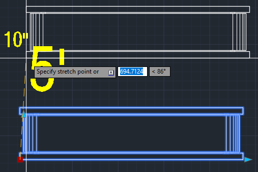

I have a block (attached) that show dimensions only when a stretch action is applied. I want to replicate the block behaviour in other blocks but there is a layer configuration i am missing. Here is the block:1.PNG
Here are the dimensions that appears when the stretch action it's been applied
There are 2 things to know here
1. The dimensions are in a layer called "Dynamic Dim" that hides when the stretch is not been applied (This is what i want to do)
2. The dimensions are selected in the object list inside the stretch action in the block, so when the stretch changes so does the dimensions

Simply turn the dim layer off and it will function as you desire.  See screencast.
Thank you for your fast reply, it worked.
