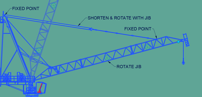

Hi there, hoping someone can help me out. Newbie here, only just learning how to create dynamic  blocks. When I add a rotate to a mobile crane boom I can't manage to keep my hook and cables at 90 degrees due to angle of boom changing. Hope this makes sense.

I have a question in line with Rob's request. i'm also working with cranes (tower cranes) and i started learning dynamic blocks recently. Is there a way i can rotate the jib but with it also stretch and rotate the pendant lines as i have noted below.

That should be possible. Post your block so I (or some other) can demonstrate a way ...

Attached a simplified schematic solution.
Jürgen Palme
Message 7 of 23
maviles06
Thank you so much!! that is exactly what i'm looking for. What were your steps, i have to reproduce this for various makes and models and jib lengths as well? i have tried in many ways to use the commands you have in the dynamic block but was unsuccessful in achieving this. i used your previous video on this thread to keep the line vertical as it's rotated, very helpful on maintaining the hook vertical!!

What shall happen with the both "lines" (marked with ???). They make no sense when the jib rotates (?).

That is awesome!! i see where my mistake selecting items when i added the point after polar stretch vs just selecting the polar parameter. The two lines will in question will rotate the same as the pendant lines. i will apply your polar steps to the safety lines as well!! much appreciated you saved me a lot of time when i have to rotate the jib on job layouts!!! my appreciation is understated in this comment.

i will be sure to revise those two added actions into my block, i did notice that when i would rotate the jib. I have a new problem which arose as i was adding the tower sections into the block with array for incremental values on the sections. when i stretch the sections the rotate and stretching of the pendant lines gets nullified. Do you have any idea why this is?

You moved the complete crane geometry in y-direction, but the stretch frames remain on their initial (and now wrong) position.
You must repair all the stretch and polar stretch actions.  (one by one: Right click -> modify selection set - pick a correct stretch frame).

To move the geometry upwards you must not use the MOVE command. Instead use the STRETCH command: Select all geometry including all actions completely inside a selection frame. Before you must have set BACTIONBARMODE to 0 (to be able to grab the actions).
