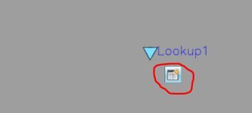

At the command line type BACTIONBARMODE. Change the value to 0. Now double click on the lightning bolt.
See the image below

It should do. That image I posted is the only thing in the block.
Post a drawing which contains your lookup so we can have a look at it.
