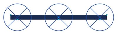

To simplify my question, I have a block which consists of a polyline with 3 circles drawn along it.
I need this to be a dynamic block where the polyline ends can be moved (stretching the polyline) and the circles can be independently moved along the polyline, but not past, either end of the polyline.
I have attached a dwg with my attempt in it.
What i can not figure out is how to prevent the circles from moving past the right end of the polyline.
The circles must not be allowed to be moved outside of the endpoints of the polyline.
Is this possible?

How do I hide the blocks insert point grip so that I can grab the arrow grip underneath it on the leftmost circle?
Message 15 of 16
j.palmeL29YX
I don't know how to hide a blocks insert point grip, but you can place the grips of the parameters a little moved in vertical direction.
So also the grips of the polyline and the grips of the circles will never be overlapping.
Jürgen Palme
