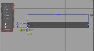

I'm trying to alter a dynamic block that I have created and its not working... everything I've tried so far has come to no avail... can someone help or assist?
inside the attached ductwork block... in the Square visibility state I've added an access panel (AP)... and what I've been trying to do is, is to get the access panel to say central to duct outerlines, so when the duct width changes the access panel stays on the midpoint.... I still want the access panel to be able to move along the centre line of the duct.  and I would like the access panel to change in size according to the width of the duct.... also the access panel needs to stay square (so equal on all sides)  and the edge of the access panel to remain 20% of the distance away from the total width of the duct?

Remove the point moves and replace them with a polar move. You will need to chain the polar move to your distance2 as well . See the visibility state Square with AP in the attached drawing. You will also need to change the angle type on the polar parameter to list and leave it as 0 (see the image below), or if you are happy with the same types of grips just put a linear move in there. The green rectangle in the block is the stuff I've added. The red rectangle is stuff which can be removed.

the only thing I've noticed, is that when you use the stretch action from the basepoint to stretch the length of the duct out... the basepoint doesn't go with it, it separates... or leaves it behind..
is there a way of when I'm stretching the duct out the basepoint always remains at the end of the duct?
Message 27 of 31
h_s_walker
Use the basepoint parameter and add it to the left side stretch. See the image below

perfect!  Thank you!  🙂
