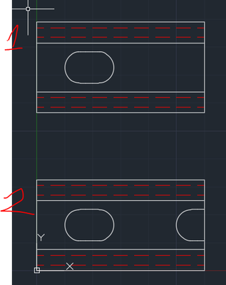

having an issue with the dynamic block array not sure how to do this
coby.j.alexander
while stretching "1" the oval inside is not matching the block on "2"
I'm trying to recreate the "2" dynamic block but i cant get the "1" dynamic block to do the same. please help.

GeeHaa
Can you Post the Drawing?
coby.j.alexander
here is my and the previous block
coby.j.alexander
dwg
