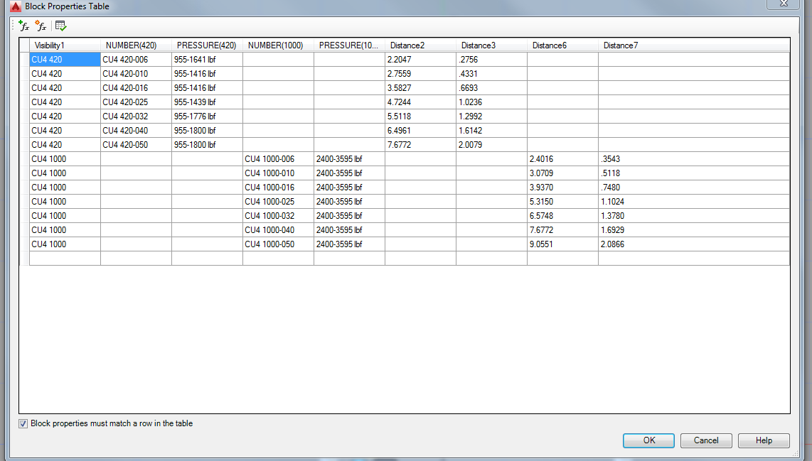

Message 13 of 14
I followed the steps previously described and i am having some issues with the table and the attributes and drop down showing in the model space...i attached my file as well as a snip of what i have listed in the table.
Message 14 of 14
Libbya
You cannot leave any of the cells empty.  They all need to have values.  The linework controlled by those cells are not visible when those cells would be active so the actual values are irrelevant, they just can't be empty.  You also need a row on the table to match the as-drawn state of the block, including default attribute values.  You can hit the Audit button on the block properties table to see if there are errors that will prevent it from being displayed when the block is inserted.  You need to pay attention to which direction you make linear parameters, especially if their values are going to be manipulated by a block properties table or lookup.  The base point of the parameter is the first point you select when creating the parameter.  The end point is the second point.  When the parameter value is changed by a BP or Lookup, the basepoint does not change.  The end point changes.  If your action is associated with the base point, then nothing happens because the other end of the parameter is what is changed by the BP value change.  Here's a video showing my diagnostic and repair process.
