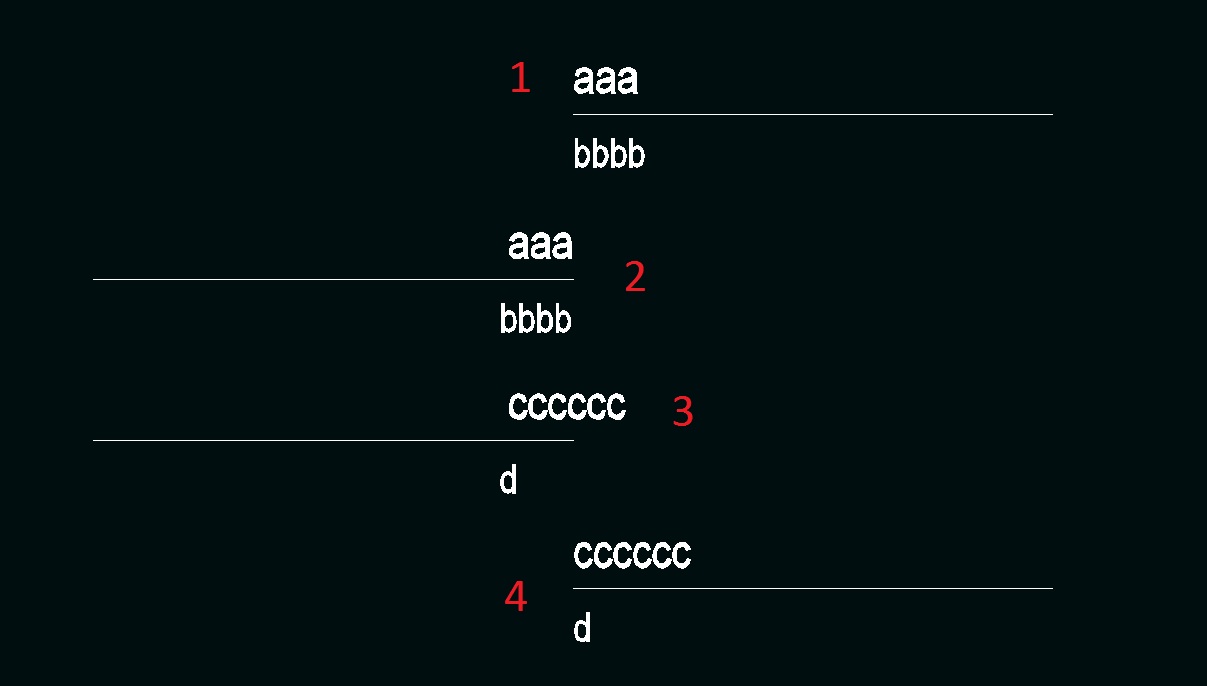

Hello Everyone,
Please check picture below and dwg attached.
As you can see when attribute is flipped(#2), the justification doesn't. So if you edit the text (#3), you need to reset the block (#4) then flip again.
To avoid this one step extra action, what would you do?
Thanks and Cheers,
Behzad

I do not believe there is any way to dynamically change the justification of a single attribute.
REGEN lets you see the change immediately but if the FIELDEVAL sys variable is set to 32, it will update the field at save, close, open, plot, etc...  If a user makes the edit and doesn't regen, it will do so automatically, eventually.

If you don't want add visibility you can simply scale attributes

attsync

Thanks. This is what I didn't try. Simple things you do that can fix big problems.
I can add a discription on "Flip" grip, asking the user to run Attsync if they do Flip.
If I could make the "Attsync" automatic if any attribute gets modified, it would have been perfect.

attsync is the answer. After you edit an atrrib which has been flipped, you need to do attsync to fix the alignments.

I think if you make the AttTribute multi-lined, fix the Justification appropriately then the justification will flip with the grip.
