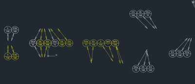

Hello everyone.
I have a problem with a dynamic block I created.
When I use and fill the texts, ok! But when I copy and paste into another file or into the same file, it comes out inverted (both copying normal and copying with reference).
Does anyone know what it can be or how to solve it?
Obs_A.dwg
Obj_B.dwg - a copy of A

Change the rotation of your blocks in Obs_A drawing. Some of them are 180. Then you will see they are upside down in that drawing. When pasting into another drawing it keeps the rotation of the block which is why they show as upside down.

The problem really happens due to rotation, but when I change it as "0" the block is inverted for reading
Normal
Changed
I don't understand is that some are with rotation "0" and aren't upside down
h_s_walker
Yeah I did notice that. I just couldn't see how to get it to look normal with rotating the block and the other parameter it just stayed upside down.
EDIT: just had a look. Someone might have mirrored the block, without realizing that they didn't need to. If you mirror the upside down block and then change the xscale from -0.5 to 0.5 it reverts to normal

Great!
Understood, it might have happened on the mirror actually, and it can be fixed by changing the scale later.
