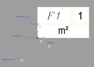

h_s_walker
@barry2104  I've updated the block. You need to use the grip which is on the middle horizontal line in at the left. See the image below (use the ringed grip). The drawing is also attached

I have downloaded and analyzed the latest version of Callout.dwg, and it is brilliant, as I was looking for something similar, but I don't understand how it works. How can I add to the list the vertex in the upper right corner? In lookup table, I add the coordinates of that vertex, but it ignores it. What does that lookup action depend on? I need to know. Thanks!

Do you need a functionality as shown here?
If yes, you only need to change this value in the Lookup2 table
from currently 4 to 6.
Or do you need additional to the current snap points a new snap point at the upper right corner?
Then examine the attached file.
If one of these meets your goal and you can not see how it works let me know. I will try to explain the "background secrets".

I had already performed this operation, but it did not work. I do not know why. I also don't know why changing the values I indicate below, it also stops working.
Now I have tried adding another snap point to the dynamic block you have sent, and it still does not work. This is what I have entered, in case it helps.

j.palmeL29YX
If you want additional snap points you also need additional lines in the other table (Lookup1). Didn't you see in my file?
Post your dwg please and also a sketch where we can see which points you want to snap.

Lookup tables visible.pngSet BACTIONBARMODE to 0, then you can see (and edit  😉 ) all lookup tables
