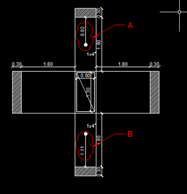

Hi, I would be happy if someone can help adjust my block please. I have this block attached in DWG file. I need somehow to create a dynamic parameter that when I input a value into an attribute definition A and B the dimensions and the circle I marked would move respectively. For Now I just added a move parameter and adding the dimension manually.
Thank you very much in advance.

In your block associate the dimensions with the lines. They will move automatically. See the link below

Thank you sir. I have managed to do that like you explained (DWG new is attached).
Is there a way I can move it not manually but by inserting a value in an attribute definition in the block?
So when i put 1.88 in the attribute the circle and the dimension will move to 1.88 from the line.

See the attached drawing
