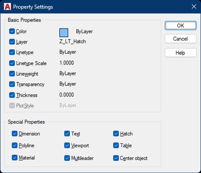

I do it all the time.
May be an issue with your match properties settings?

jriseborough
I have the same options checked.
