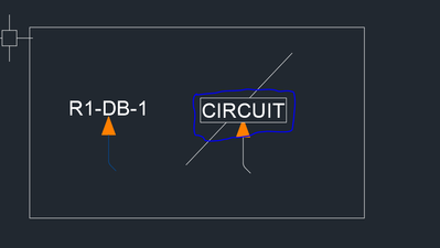

Hai, Autocad Genius,
I have a Block with an ATT, is that possible to add a wipeout into that with reference to stretch as per ATT data?
DWG and Screen short attached for reference

If I understand right what you're looking for try this: instead of a Wipeout use a background masked attribute.
To get this, follow these steps:
"... select "Multiple lines" in Attribute Definition window (ATTDEF command).
Than after you enter Tag and Prompt values, click on [...] box for Default. Next, specify location of attribute and select Background Mask from options icon at Text Formatting toolbar."
(cited from >>here<<
Jürgen Palme
smallƑish
Thanks a lot
h_s_walker
As a little bit of extra help. Change the Multiline text width to 0
This has the effect of "stretching/shrinking" the mask to the exact width of the text you have written.
