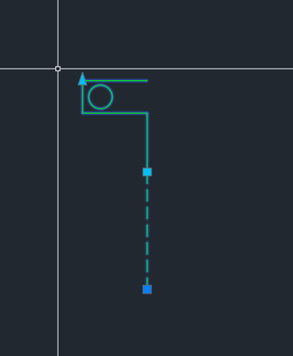

I hope you can help me. I'm creating a dynamic block which uses an array and a stretch action to repeatedly copy an object (just a circle). The issue is that the circle is not copied at the first step or increment and seems to "lag behind" at every subsequent step. How do i solve this?

When the associated parameter is 2X the column/row offset, the first new object appears.  Adjust your parameter length accordingly.  Use a chained gripless parameter for the array if necessary.
Post your block if you need further assistance.
