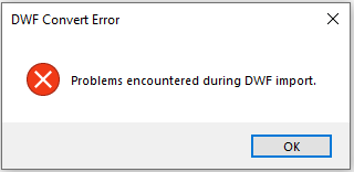

Installed ADR Hotfix 3 last week, now PDF is not a supported file and there is no way to import a PDF to ADR.  Was this an accident or a permanent change?

It says the file I tried to open is not supported. PDF is no longer listed in the supported file types drop down when trying to open the file. Drag and dropping the file into the program also gives the file not supported error. We rolled back the software version yesterday to the previous version and the PDF function continues to work fine there.

That's quite true!!😳 I've upgraded my ADR to Hotfix3 and that's what I get when opening PDF files:

Yeah, that's the error I got. No PDFs work. Our solution was to revert back to roll back to the previous version. Is there a way to report a bug? or do you just hope you're lucky enough for Autodesk to read the forums?

Also updated to hotfix 3 and I find some pdfs don't open but some do.

Open those PDFs in Acrobat Reader or any other 3rd party PDF reader, go to PROPERTIES for each PDF file, and find out what the differences are: versions most likely, but you'll never know if you only rely on old-ADR for your PDF viewing needs.

Having exactly the same problems. Pdf-files (Adobe or Foxit - no matter) older than mid 2019 is no problem. Newer files are impossible to open. Getting the message as shown above in message nr. 6.

I’ve already tried with several PDFs! No way to open unless I roll back to an earlier update of ADR.
