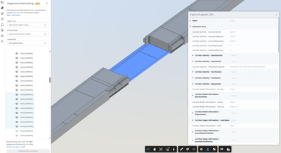

Hi all,
The new Civil 3D Cloud Data Exchange really looks promising and useful.
I already used it to transfer geometry from a C3D roads model into Revit.
A few remarks:
  • The geometry showed up nicely in Revit but the geometry does not contain any properties from the attached Property Sets (created
This is the source model (corridor solids extracted):
This is the Data Exchange:
Something seems to be missing because transfer of data should be working, according to this:

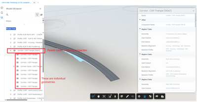

rakesh.borse
@DonnyVA
For properties, please select the parent node of the selected geometry in model browser.
For any other queries, I'll get back to you soon.

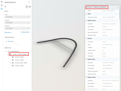

Hi @rakesh.borse ,
What is the parent node of extracted corridor solids?
Maybe these aren't supported (yet)?
I also created a Data Exchange of a Corridor (so the solids are created automatically).
In Revit, I loaded that Data Exchange but that generates one big object.
This is probably a limitation of the Revit Data Exchange (2025)
For a Corridor, there are indeed properties but still not on solids level. Only on the Corridor itself

rakesh.borse
So, when clicked in the viewer, the geometry is selected and hence it looks like properties are not present. But properties are attached to the parent node of the geometry. So please try selecting it from model browser. See below screenshot.

DonnyVA
Hi Rakesh,
Yes, I did that in my post above and also here:
As you explained, the data is only on the full Corridor currently.
If you would load this Data Exchange in other software (Revit), you are unable to filter the solids based on a property.
I think users would like to have the properties of the solids too.
In the example of loading a Data Exchange in Revit and show them in a Revit section view:
  • You could filter visibility of solids based on their property
  • You could apply colors based on their property
Is properties on Solid objects on the roadmap?
