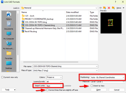

Navigate to the Insert tab, and click on Link CAD…
Browse to and select the Civil 3D file you WBLOCKed out. Change the Import Units to Feet, uncheck Correct lines that are slightly off axis, uncheck Orient to View, and for Positioning, change to Auto – By Shared Coordinates…
A dialog box will appear on the screen. Select the Align option…
You may get a prompt about the Shared Coordinates Are Not Set Correctly. Click Close on the dialog box…

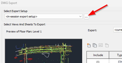

It’s important to check your work before sending it to a client. To check your work, you will export this file out of Revit and then XREF it into Civil 3D. If it lines up correctly, then you will prepare the Revit file to send to the Revit users on the project.
Navigate to File>Export>CAD Formats>DWG.
In the DWG Export dialog box, click the ellipsis next to <in-session export setup>
Click on the Units & Coordinates tab. Change to Foot and Shared Coordinates.
Click OK. Click Next and then navigate to a folder to save your file. Make sure to uncheck the box Export views on sheets and links as external references.
XREF the newly exported file into Civil 3D and ensure that it aligns properly.
