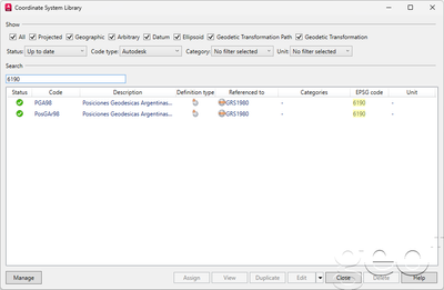

  4. It actively confuses users today. Search the library for "6190" and you get PGA98 — an Argentinian datum (the EPSG datum register happens to reuse that number), while the Belgian compound CRS with the same code is nowhere to be found. Search for "8370" and you get an empty list. Users reasonably conclude the library is broken or incomplete; in reality the data model has no place for these systems.
