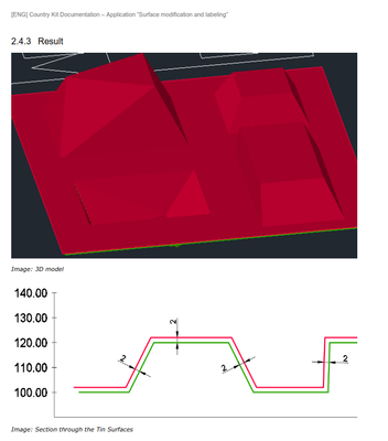

We need the ability to offset a surface. Landfill caps and certain types of excavation or fill need to be calculated this way. I WAS doing this in AutoCAD back in the 90's using a program called QuickSurf. Fifteen years ago I tried to write a lisp to do this using the NOR function in the Geometry Calculator. But, not being a programmer, I never finished it. So I believe this it doable but I don't know how much work it would take.

A flat surface can be offset using the Raise/Lower command. However, for surfaces with varying slopes, this approach is incorrect, as the offset should be perpendicular to the respective surface at each point.

I've found that:   The tool "C3D CK SurfaceModification 2024" in German country kit provides the offset function
https://download.autodesk.com/akn/2024/civil3d/country-kits/dach/dach_content_c3d_2024.0.1.exe
According to version history, this tool is developed since 2020
For Civil 3D 2025, the "DACH Civil 3D Country Kit 2025.1 for Autodesk Civil 3D" is hosted at https://manage.autodesk.com/products/updates/
