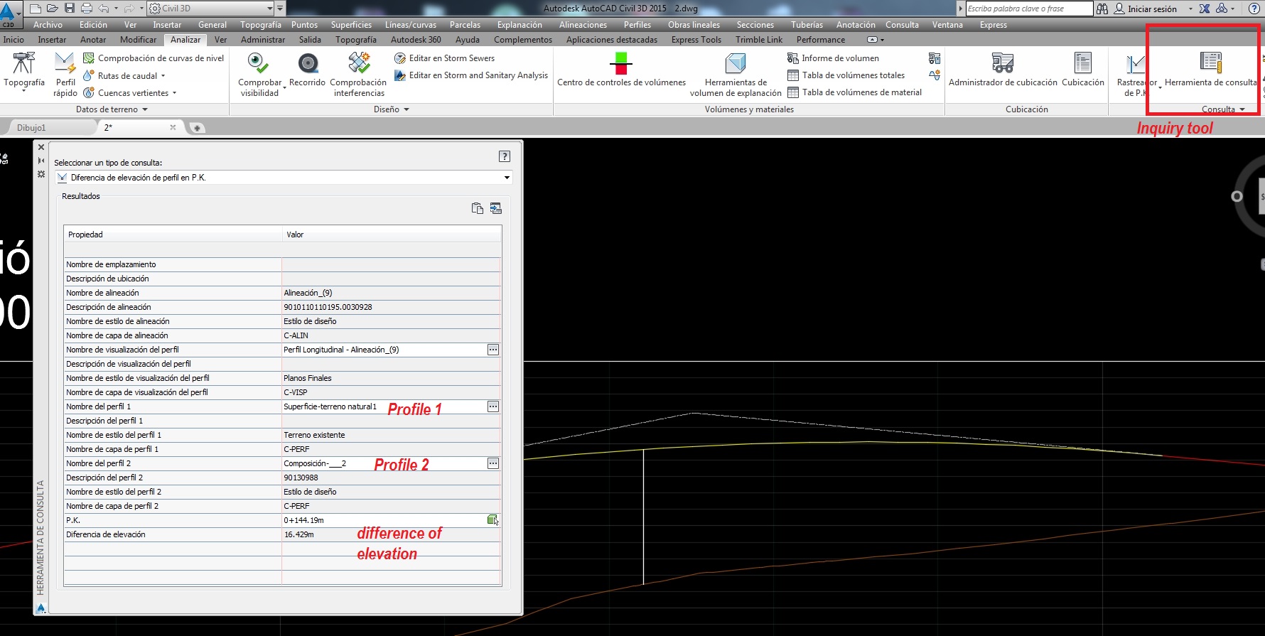

This is the Istram Ispol software, where I can label the difference elevations between 2 profiles in the same profile view in a frecuency of 10 meters:
We can use the Inquiry tool to check this difference elevation  in a particular station:
But I prefer show the labels inside the profile view. I think that it is a better way.
