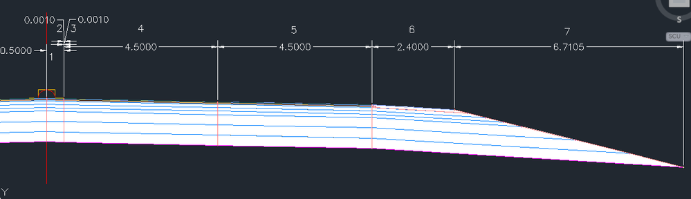

javiermend
start assembly-7 parts with diferents wide lanesstart assembly-7 parts with diferents wide lanesFinish assembly-7 parts with diferents wide lines.Finish assembly-7 parts with diferents wide lines.
With regard to this question , is a pity that Autodesk don't take care about this question in the near term. It would be a clear competitive advantage that would put in equal conditions with others common software like Istram, Clip or Inroads.
It is not use to having diferent kind of assemblies between start and end regions with diferents number of layers and lanes.
In the photograhs, the finish assembly has 7 parts and the parts with number 2 and 3 has a symbollical wide such as 0.001m. In the star assembly this lanes has 3.2 m and 3.2m , so that the transition should be 3.2m to 0.001m.
Under my point of view if we employ coherence in the definition of the assembly, linear or parabolic transitions shouldn't be a programing problem for autodesk developpers, will it?
