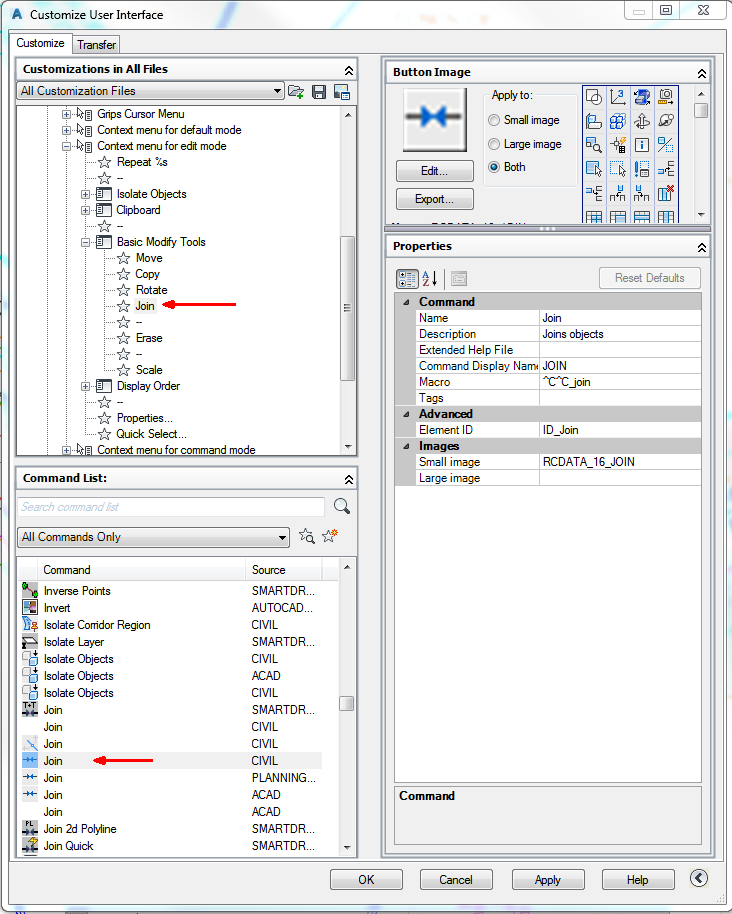

AllenJessup
Add JOIN to the right click menu. Select the entities, rt-click, select Join.
Use the CUI to customize the rt-clk. Open the CUI and find Shortcut Menus and expand it. Expand "Context menu for edit mode". I added mine to the "Basic Modity Tools" but you can put it wherever you like. In the Command List find Join. Make sure it's the ACAD Join and not the Civil Join. Drag it from the Command List to where you want it in the shortcut menu.
Edit 1: And - of course - I pointed to the Civil Join in the image below. Looks 2 down from where I pointed to see the ADAD Join.
Edit 2: Actually that join will work. It's the 2 above that won't work (for joining arcs and lines anyway). Could they add a few more joins?
