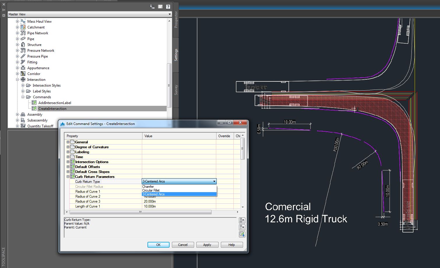

Our Council now requires compound curves for kerb returns. There are different curve radii required for different scenarios. Could we please have an option for compound curves when creating intersections using the intersection tool. The variables would be:
  - Extend Profile along Incoming Lane
  - start of alignment with line over set distance to set offset width
  - first curve with set radius and variable length
  - second curve with set radius and variable length
  - end alignment with line over set offset width set over set distance
  - Extend Profile along Outgoing Lane
