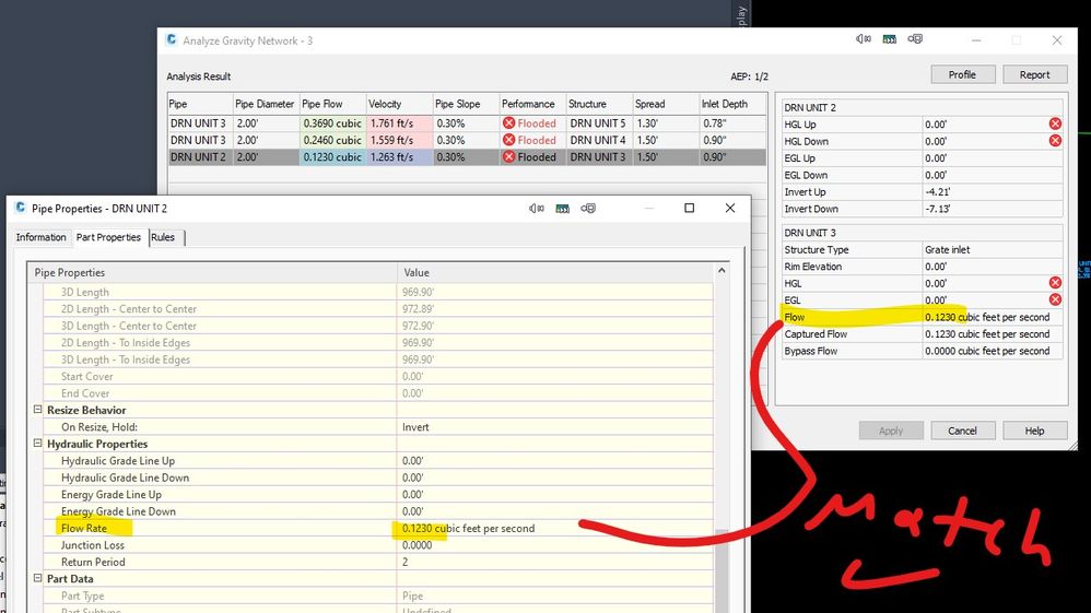

Can we get the Analyze Gravity Network routine to change the flow rate values in the pipe properties?  It changes the EGL/HGL values and the field is already there.

Hi @TimYarris , here's another that has be completed and can be closed 👏 🙏

Thanks to @KirkWM for the reminder!
fner99
@TimYarris what version was this implemented in?  Been waiting years for this!
TimYarris
@fner99 , I believe this was added in Civil 3D 2022.1
