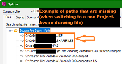

You're a Project Administrator and setup Project-Aware for your project, correctly pathing items that are considered important for your project, such as templates, additional support paths and the like - all well and good. The problem is that, when implemented the "My Settings" and "Classic AutoCAD Settings" do not account for all user settings and often pathing is removed aside from bare-bone basics.
Example of Project-Aware project Options configuration
Example of regular non Project-Aware drawing file Options configuration
As you can see, the support file paths are different and don't follow the base setup, so you have now lost all of your customization on your new Project-Aware ACC project. This is a big problem when you work on a multi-consultancy project where each company has it's own base settings / customizations that you don't want overwritten.
