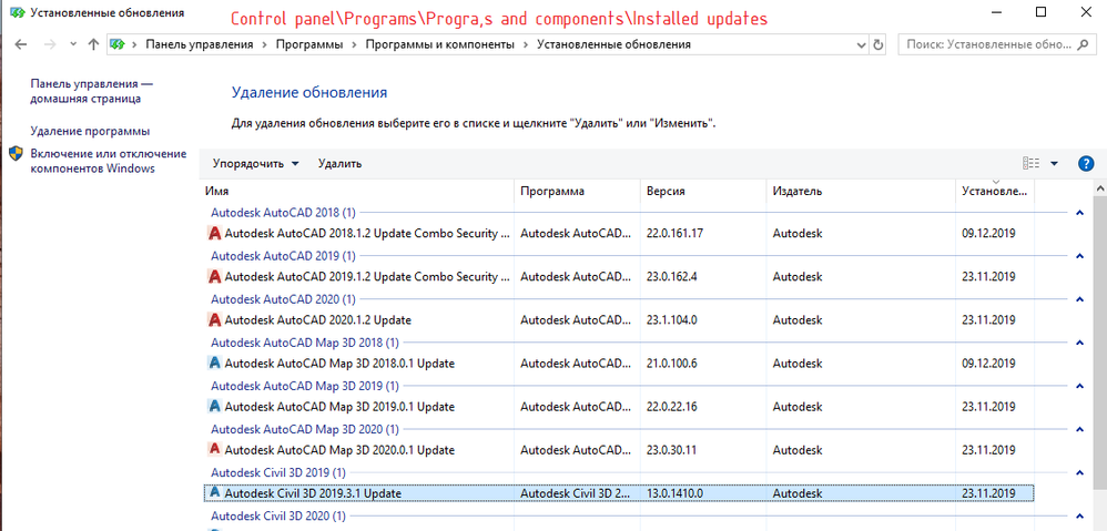

Hi, most popular way - with Windows Control panel here (in place with installed Updates) and reboot your PC:
 But actually it's maybe not working in some Cases
