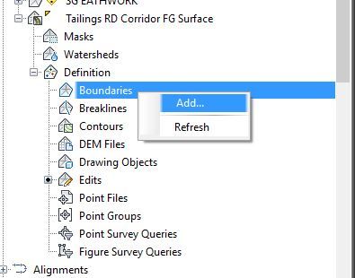

Hi @Anonymous!
Yes, I realized after my first post that you can only have one "outer" interactive boundary per corridor surface.
However, please try the method shown below.  You need to create interactive "hide" boundaries around the corridor void regions.  Please see attached.
**EDIT:
Another option is to create closed polylines around each corridor region and then add these to the corridor surface itself in the Prospector\Surface collection.  You will start with one "Outer" Boundary (for first corridor region) and then you will add the remaining corridor region boundaries as "show" boundaries.
