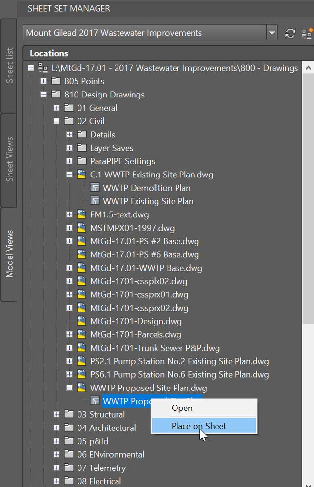

hencoop
It is a feature of Sheet Sets and views added to a sheet using the "Place view on sheet" tool in the SSM Model Views Tab".  The ViewportScale field is a placeholder field available under the Field Category "SheetSetPlaceholder":

Views added to the drawings from the SSM can have dynamic labels. The view numbers, sheet numbers and titles are managed within the SSM. Dynamic blocks with SheetSetPlaceholder fields for these values allow ALL titles and callouts across the entire Sheet Set to be automatically and dynamically updated because the field values are links to the specific sheet and view listed in the SSM.  A single edit in the SSM causes ALL references throughout the SheetSet that refer to that sheet number or that view to be updated.  Implementing this feature completely eliminates any need to check titles and callouts on individual sheets.  The only place they need to be checked is within the SSM.   My problem is that the ViewportScale field is misbehaving in View Labels in some of my views.
 The SSM uses two (user created) dynamic blocks to accomplish this:

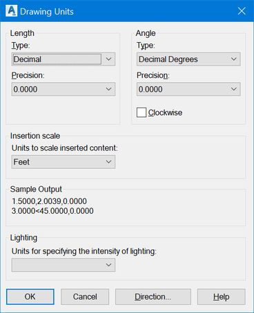

I did some additional checking:
There are several Xreferences.  Some had a blank line their scale list.  Others had scales appended with "_XREF"  I deleted the blank lines and renamed the scales with "_XREF".   If the scale name already existed I just removed spaces or added them to make another similar scale name.  That seemed to clear it up but then I started having a new problem.  As long as the Format selected is "Use scale name" it seems to work okay now that the "_XREF" are renamed and the blanks are removed.  I did need to put the name I preferred at the top of the scale list for it to be used.  Still very confused but at least I can get the correct scale format so far by using "Use scale name" and removing blank scales and renaming Xreference scales in all of the xreferenced drawings:
Initial Scale of New Model ViewInitial Scale of New Model View
The above result is likely because the block definition specifies the scale format #" = 1'-0"
New Drawing UnitsNew Drawing Units
New Drawing Viewport ScaleNew Drawing Viewport Scale
Scale by Name OKScale by Name OK
Format 1" = #' is not OK (divides 30 units by 12 and renders that in feet)Format 1" = #' is not OK (divides 30 units by 12 and renders that in feet)
Xref and Blank ScalesXref and Blank Scales
Only a single Xreference drawing was included.  some others are really big.  I think the one will be enough to check out what is going on.
