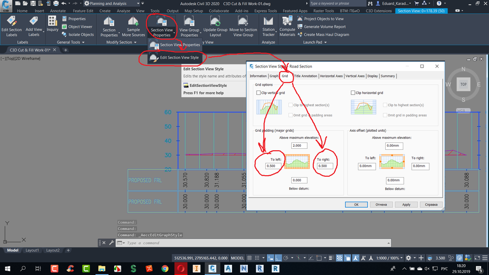

Also I would like to fix the outer boundary band width always 50cm left and Right side for the clearance. (Clouded)

About clouded places - try to do these steps:

About blue lines - I recommend you to create a simple corridor, then set a special label style for neccesary points (using Code Set Styles). It's not so quick as earlier way
