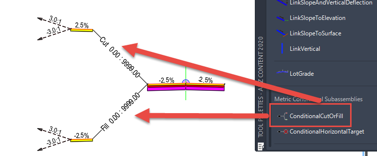

I have a corridor with a grass verge with a nominal 2.5% crossfall away from the carriageway, with a 1:3 cut/fill daylight at the end (see attached assembly).  Where the road is in cut, i want to change the verge to fall the other way, towards the carriageway.  What is the easiest way to do this?
Do i have to create separate assemblies and separate regions for cut/fill sections?  This would appear to create a lot of work.  Is there a simple way to override the subassembly properties over a specified chainage range?

Hi @Stewart.Hellen ,
Use conditionalCutFill subassembly. Then set both condition as needed.
See animated gif as a guide.
Animated gif - GuideAnimated gif - GuideSample ImageSample Image
Guide2Guide2
