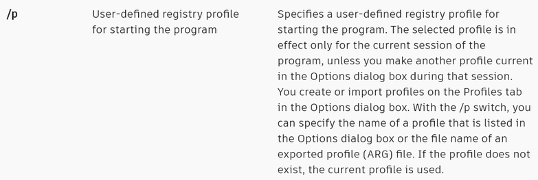

I don't know about the seed file. But, if you're opening Civil 3D with the desktop icons. Imperial will open set to feet and metric will open set to meters. The Profile is set in the Target line of the Icon properties.  /p "<<C3D_Imperial>>" for feet, /p "<<C3D_Metric>>" for meters. This also goes for opening from the Start menu. That links to a shortcut in C:\ProgramData\Microsoft\Windows\Start Menu\Programs\Autodesk Civil 3D 2024 - English. The shortcuts there contain the same properties as the OOTB Desktop Icons.
