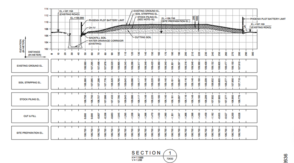

Hi Autodesk Community,
-I have an existing surface varying elevation 104.420m ~ 109.740m.
-First, I have to remove 200mm Soil Stripping,
-Second, apply 1m stock piling but up to elevation 106.750m only.
  here three cases can arise: -
  Case-1). apply stock piling fully for 1m.
  Case-2). apply stock piling partially 0m~1.0m up to elevation 106.750.
  Case-3). not apply stock piling if stripping elevation goes below elevation 106.750.
-Third, do cut & fill to reach elevation 106.750 (site preparation elevation).
-Fourth, model PVD working platform of thickness 400mm from elevation 106.750.
What is correct method to do all this task accurately.
for now, I am doing,
import contour data and create existing surface, offset it 200mm for soil stripping,
offset 1.0m for stock piling, then I have made different surfaces for flat area (106.750m) and varying area (above 106.750m) marking it to plan, then combined these two surfaces into a composite surface to calculate earth volume. I also marked area where stock piling not coming (below 106.750) and hide it from boundary.
Problems occur: -
surfaces do not connect properly at intersection parts; they catch connecting parts up or down 1mm~50mm approx. that effect values coming on elevation Bands created by me.
Material hatches not come on some profile.
Please suggest correct method to perform all this task
